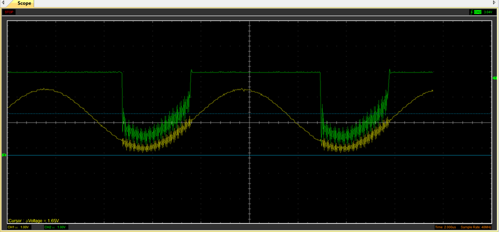

To verify its normal behaviour, I chose Vref/2 as INM and I plugged a sine generator on INP. Hence, as I enabled an external output, I expected to see a PWM with a duty cycle of approximately 50% but instead I got the following oscillogram.
The input is in yellow, the output of the comparator is green and the theoritical value of the ither input of the comparator is the dotted blue line.

I tried to generate the sine with an onboard DAC first then with a dedicated generator but I got the same results. There must be a physical problem because the noise of the Comparator and the source's one have the same period and amplitude and have a 180° phase shift. So I guess this weird output generates a current draw that affects the input. But I can't figure out why the comparator behaves so weirdly, it doesn't even shift when the signal goes below the reference.
