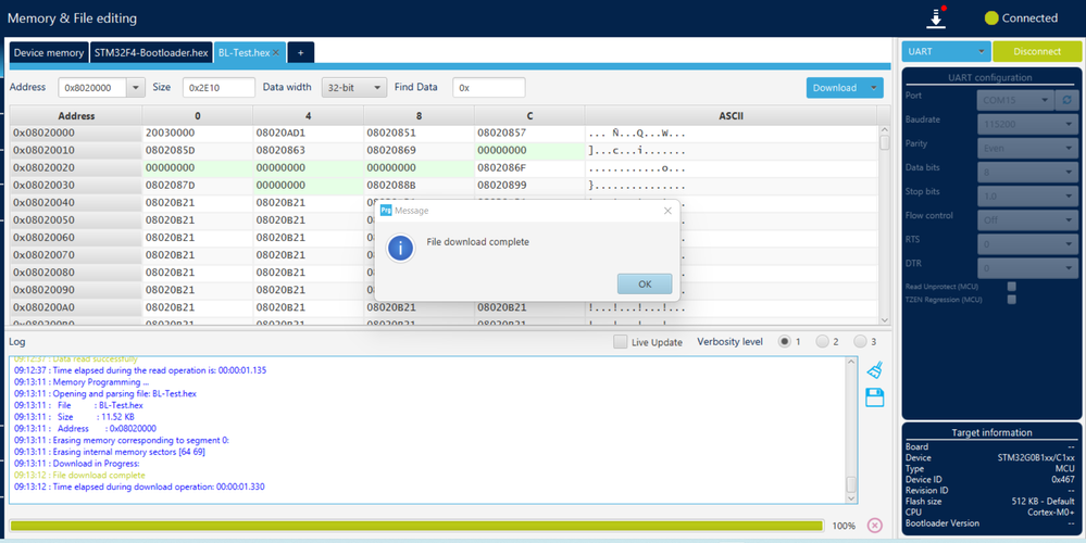

2023-06-12 8:55 PM - edited 2023-11-20 3:26 AM
Yes, I'm using UART protocol
See above attached image every thing is fine (read/ write)

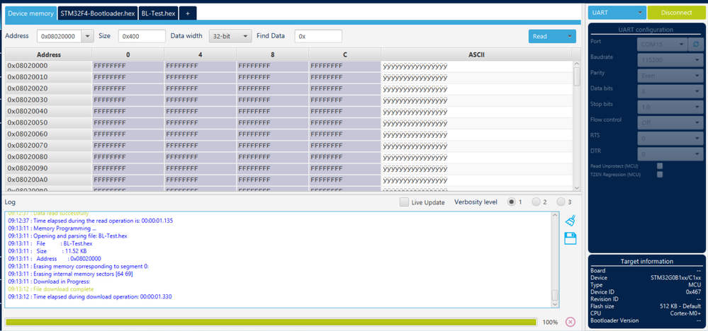

but if i varify the memory its showing fffffffffffffffffffff
as show in below image
2023-06-13 6:33 AM
Click "Read" again so it updates the memory. Your log should have "Time elapsed during the read operation is: ..." as its last line. If you look at the log, the last read operation was prior to the download.
