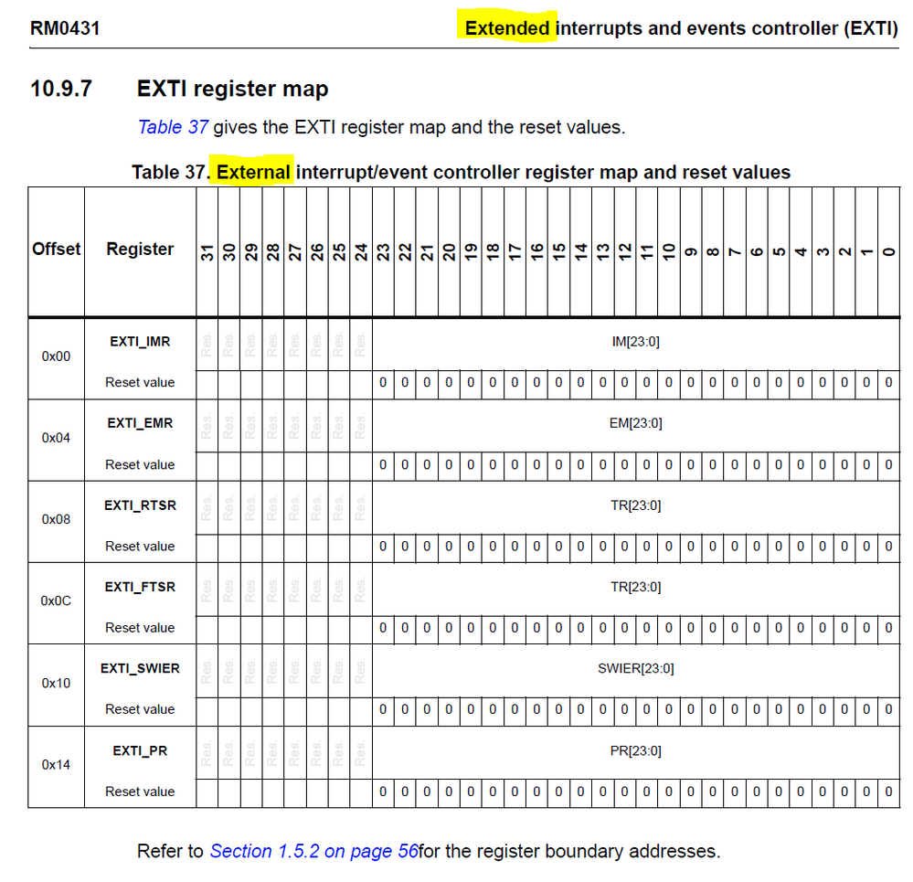

Seems the manuals aren't consistent either, at least not the F7 manual:
But agreed, it hardly matters.
