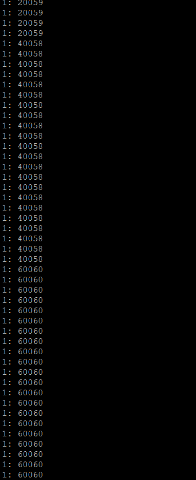

Wow, thanks for the quick respond. So after some reading in the datasheet I doubt that my Board can recognize both edges of the pulse (maybe because it's just a STM32F103RB Nucleo board). So I stayed with the method of changing the polarity of the Channel in the Interrupt Routine.
I further developed the code with you really helpful tips, but somehow i can't get it work.
Here is my new code for only one channel:
if (htim->Instance == TIM3)
/*/////////////////RECEIVER CHANNEL 1//////////////////////////*/
if (htim->Channel == HAL_TIM_ACTIVE_CHANNEL_2)
if ((TIM3->CCER & TIM_CCER_CC2P >> 5) == 0)
Receiver_1_first = TIM3->CCR2;
TIM3->CCER |= TIM_CCER_CC2P;
else
Receiver_1 = TIM3->CCR2 - Receiver_1_first;
if (Receiver_1 < 0)
Receiver_1 += 0xFFFF;
TIM3->CCER &= ~TIM_CCER_CC2P;
}And here is my output: (it should be something between 1000 and 2000):
