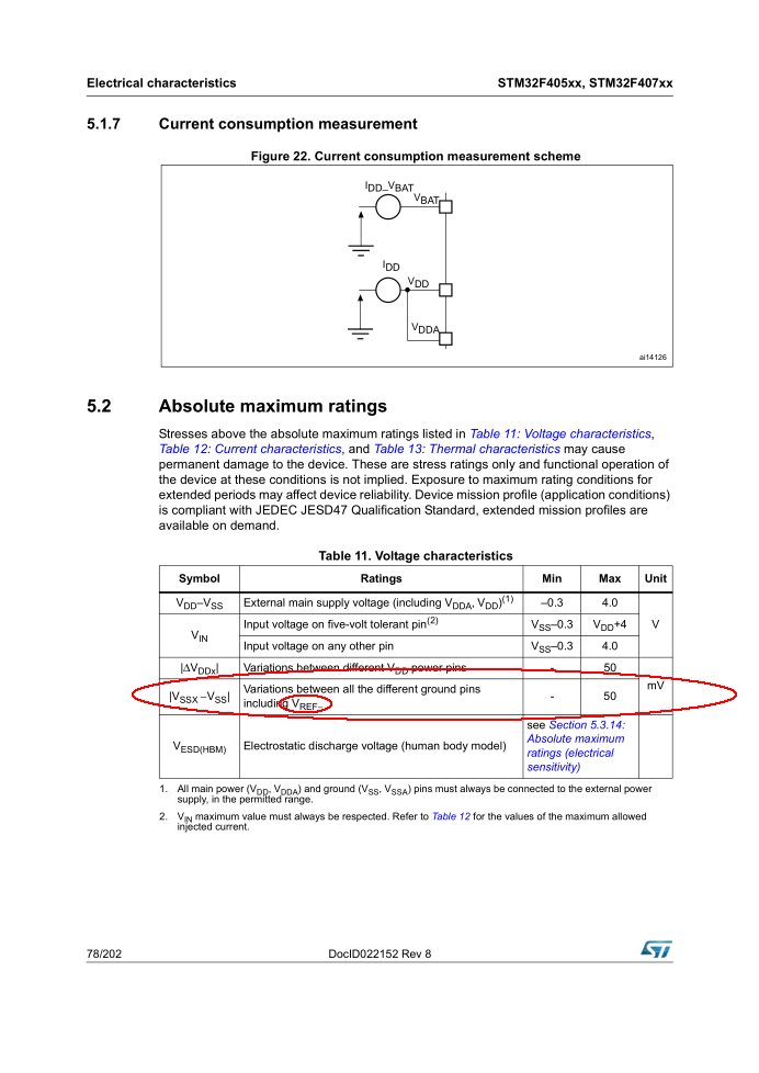

You'll find it in the datasheet for your particular STM32 model, but basically VREF- should be tied to GND, e.g.:
2019-09-13 3:16 AM
2019-09-13 6:22 AM
Thank you so much
