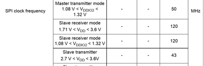

from ds :
so 120MHz max. ; how long are the wires ? ground /shield ? damping resistors ?

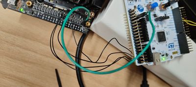

2023-06-26 5:47 AM
The physical connection is shown in the figure above.
