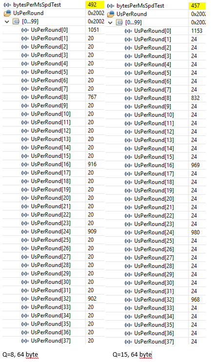

I am trying to get a hight speed write to SD via SDIO as well. I use a project generated with Cube MX, 4bit SDIO and DMA. But I only get a write speed of about 300 kBytes/s. I write 1000 times a 100 byte block, because I need a write about every 100 us. With a 100 byte block I have a write time of about 25 us, but every fifth time over 1 ms. Weird...The time span to the 1 ms write decreases the less bytes I write.
When I look at the trace of TrueStudio, I see that more than 60% of the time is spend in the function SDMMC_GetCmdResp1, compared to only 0.05% in BSP_SD_WriteBlocks_DMA... (Screenshot attached)

What do you think are the transfer peeks shown in the screenshot attached?
