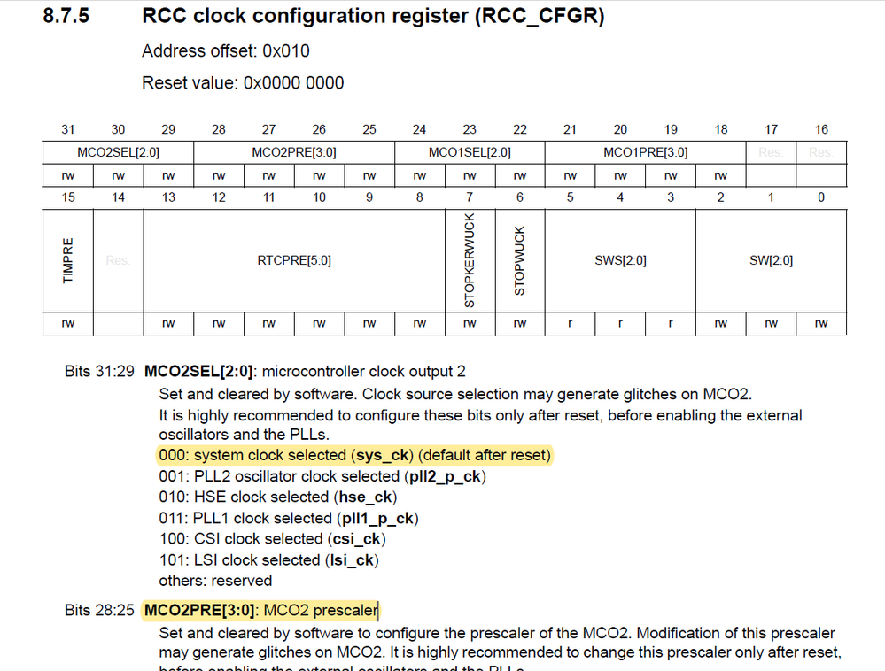

2022-03-23 8:10 AM
You can use MCO2 to output an image of the system clock:
Select a prescaler value in a such way to not exceed 100MHz.

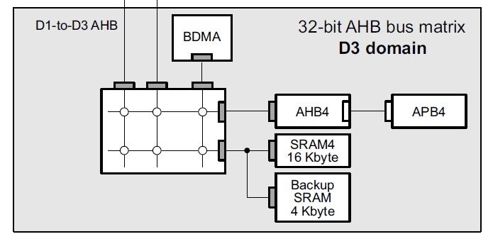

2022-03-23 11:41 AM
Bit banging the GPIO on the H7 is a lot slower than other STM32, parked off of AHB4/APB4.
Ditto driving with DMA and Pattern Buffers.
