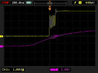

2020-10-15 11:50 PM
Dear Jan,
Thank you for the advice I will definitely consider doing this with the revised board.
Your suggestion regarding the noise on the input is more spot on. I have been looking at it with a scope and there are half mast noise messing up the edge detector. So when the input noise sits at the dead band of the edge detector it somehow blindfolds it for the next very close valid edge.
I am toggling an LED in the ISR of the EXTI and it clearly misses the IRQ when there is a specific type of noise on the inputs.
After adding a SN74LVC32 nor gate to the input pins it made the IRQs more reliable but still not 100%.
Here is my input in yellow to the edge detector.
I will be moving to the timers for a better performance as this is a critical signal required by my system. I am hoping that the edge detector of the timer channels are different to the EXTI.
Thank you again for the help.
2020-10-18 11:51 PM
Dear Jan,
I finally resolved this over the weekend.
First of all the you were right in asking about how I am detecting the problem. The answer is with my scope and it helps but is not good enough for the way the scope signal is presented. In the ISR I toggled a led and of course as in the picture above if the ISR is toggled twice the output pulse woud be very thin. So when I zoomed out it looked very often as if the micro was missing the IRQ, but instead it was not.
I modified my code to trigger the ISR only in a 100 Hz window once in every direction. Now the scope clearly shows that all the IRQs are serviced at full speed.
I love this micro it is a super machine. Thank you for your time that you spent on my request.
Highly appreciated.
Kindest regards
Wynand
