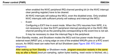

When the MCU is placed in Standby Mode, where does the CPU begin to execute when exiting the mode? (for example, on an RTC event) Is it a reset or a return from interrupt? RM0394 isn't clear on this.

It resets when exiting from standby.
RM0394 says it here:

Thanks! Maybe I should have searched for the word "execution"!
