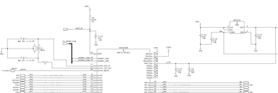

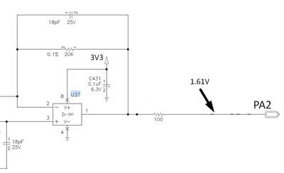

2025-09-10 5:48 AM
Appologize but can't share a photo.
The sourcing is as on attached screen.
So I am driving it through 100ohm resistor using the OPA2325 opamp.
2025-09-10 5:58 AM

2025-09-10 6:14 AM
Sorry for partial print but I can't share full schematic.
