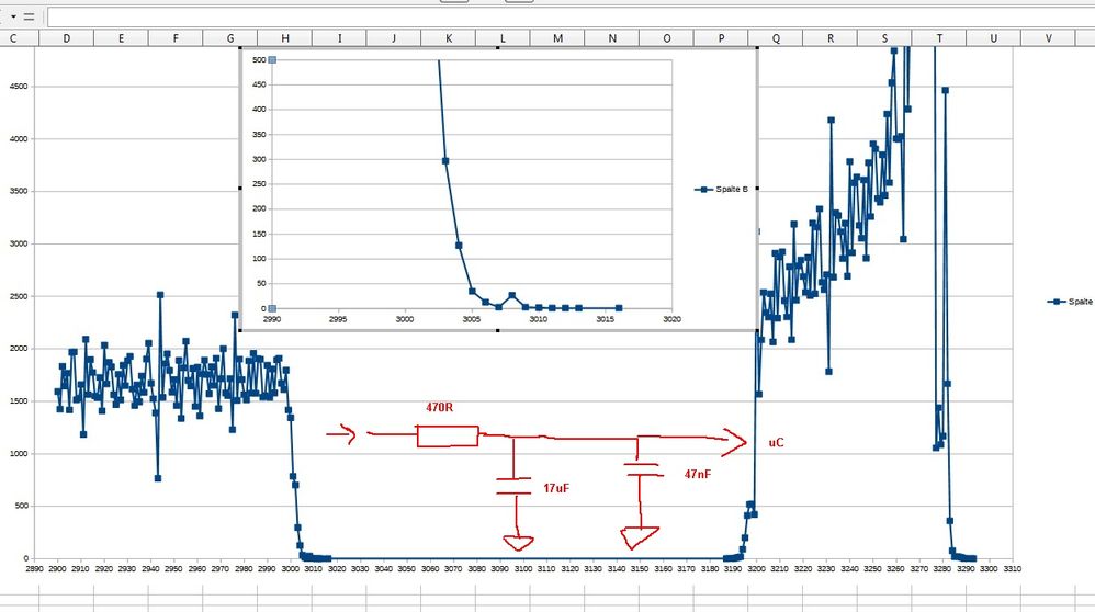

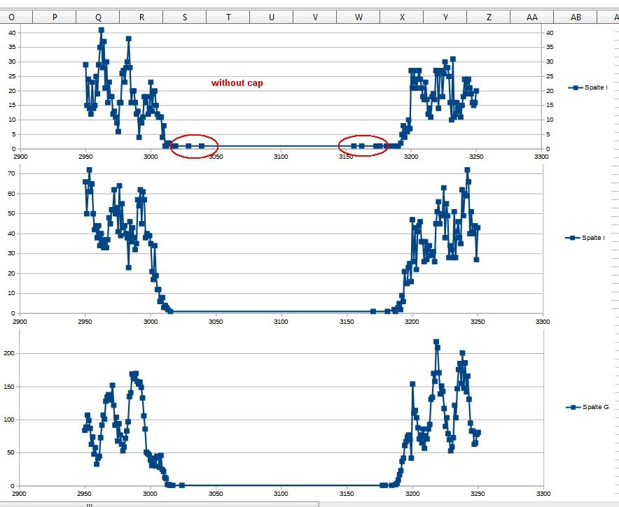

I made a diagram, to visualize it and added a cap to smooth out the signal:
x-axis shows the value from the ADC, and the y-axis is the number of measures values. The window has been changed to 3000/3200.

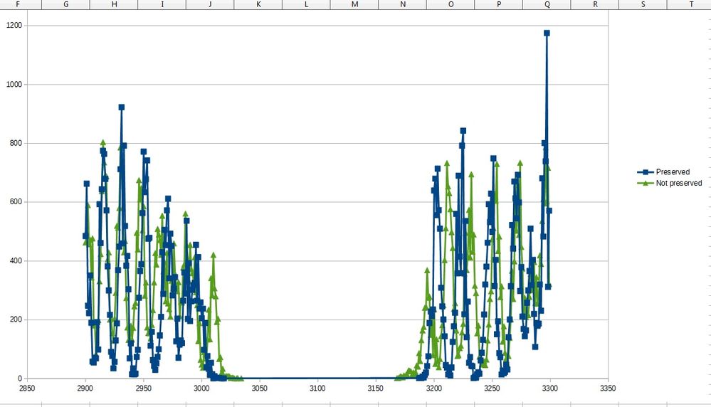

2023-04-25 6:32 AM - edited 2023-11-20 7:16 AM
I could now improve my measurements a tiny bit. As i did forget about my signal i used, there were some artifacts (valleys and mountains in the signal). Those came from the DAC that was generating the signal.
But still the values when the watchdog fires are not precise. My test setup is on a breadboard. The increasing numbers to the right are, because the signal curve flattens at higher level, and produces more measured values. The signal is a 2Hz triangular (somewhat) waveform.

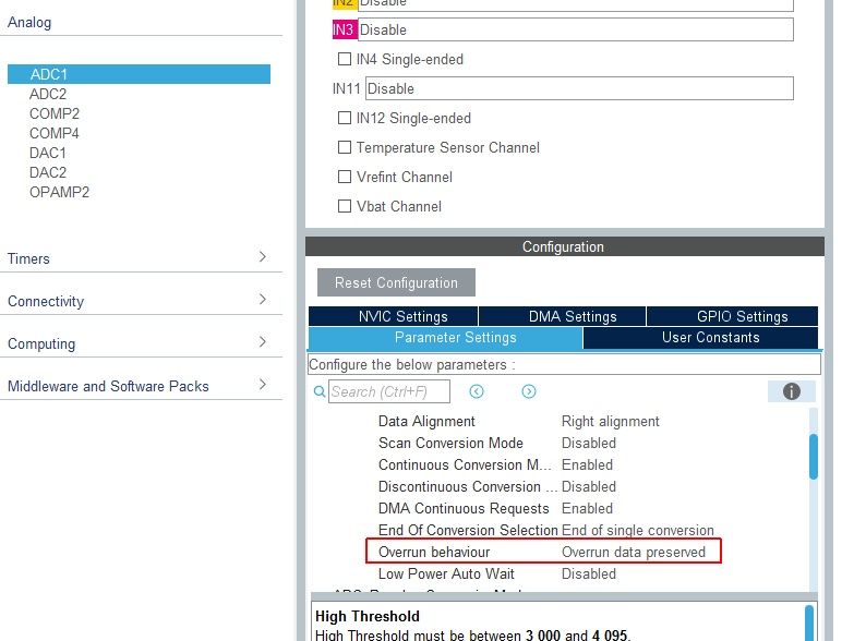

No, i have set the option to preserve the data in the register. I thought "well thats it" but i was quite dissapointed as it didnt change much. Or maybe there is more to it?
2023-04-25 10:37 PM - edited 2023-11-20 7:16 AM
I have now checked on the preserve option in particular. It works as expected. But the watchdog is still not working as it should. I have read in the manual:
