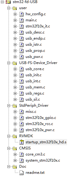

Thanks in advance for your time spent on this topic.I have spent several months on STM32 project, fine with software coding, but keep confusion on the startup file, which would appear inalmost every project as below. I think everyone of you also should be very familiar with it.Thanks~~ #startup-file

You may find more explanation on the startup file content in https://www.keil.com/pack/doc/CMSIS/Core/html/startup_s_pg.html.-Mayla-To give better visibility on the answered topics, please click on Accept as Solution on the reply which solved your issue or answered your question.
