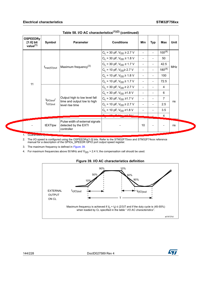

Yes. Look at the Pulse width of external signals detected by the EXTI controller parameter in the datasheet.

Hi, Tx for reply.
i referred datasheet, Couldn't found the details in it.
pls guide. As i have a routine for external interrupt iSR. Wan to know frequency at which it will fail.
2018-07-30 4:31 AM
The EXTI will catch pulses shorter than the value under that parameter, i.e. 10ns
However, as far as *frequency* is concerned, it's more about the execution time of your interrupt routine, and that's your code, I can't tell how long it takes. Measure it (either using the debug timer, or using the classical "toggle-pin, then measure on oscilloscope/logic analyzer" method).
