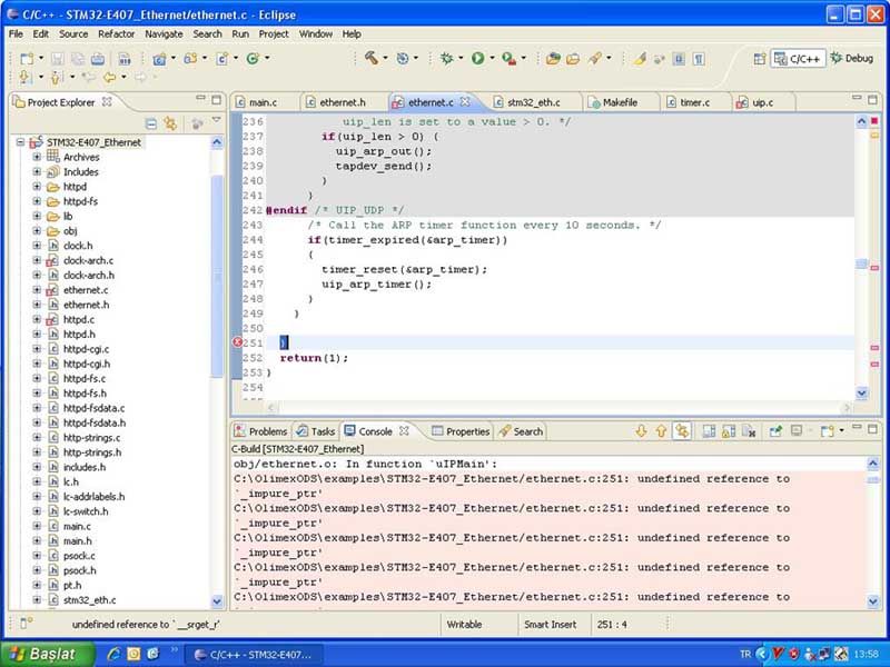

I am trying to compile a C program for STM32F4 microcontroller with Eclipse + yagarto compiler I get the error;undefined reference to `_impure_ptr' there is no function ''impure_ptr'' in whole project the error pointer points to a line containing only } -------------------------------------------- This build of yagarto use the following versions:binutils: 2.20.1

''undefined reference to `_impure_ptr'''
Where, exactly, do you get that? Show the code.''there is no function 'impure_ptr' in whole project'' Why do you think it's a function?2012-11-23 4:12 AM
hello , here is a screenshot
