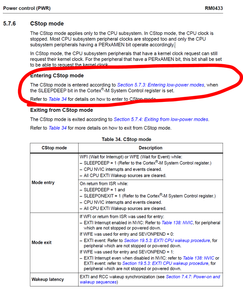

The reference manual has good information on the various low power modes.
So look for functions where SLEEPDEEP is set. This is done in a number of HAL functions including HAL_PWREx_EnterSTOPMode.
