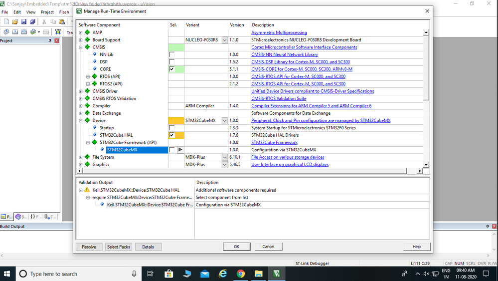

2020-08-10 10:00 PM
@prain
yes you are right.
please clear one thing also to use HAL library in keil is it compulsory to use CubeMX. because when i create a project in keil and select device > startup or device > STM32CubeHAL it says configuration through cubemx is required. as shown in image
2020-08-11 9:24 AM
you don't need to make a new project in keil from scratch. cubemx generates all thing you need (source files, keil project file and ... ). It is the fastest way you can generate new project. Take a look on cubemx page in st website. there are very good documents to start.
2020-08-11 9:43 AM
@prain
Yes I have done 2 projects by directly creating project from cube mx
Configuration of each pin, clock in cubemx and generating keil project with all configuration code written by cubemx.
That's very easy.
