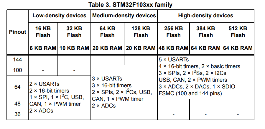

what does the datasheet mean ? This is the STM32F103C8's datasheet.
In Medium-density devices has 1xPWM timer and 3x16bit timers.
i know that 16bit timer can be PWM function.
What is the difference between 16bit timer and PWM timer?
STM32F103C8 timer has timer 1�?timer 2 ...timer 14, this is not 14*timer but 3*timer.
why?

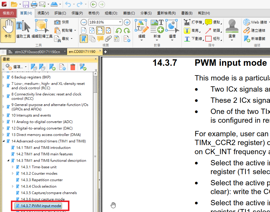

Read the PWM timer definition in the Reference Manual.
Maybe it's the old name for Advanced Timer? (triple PWM for brushless motor control)
