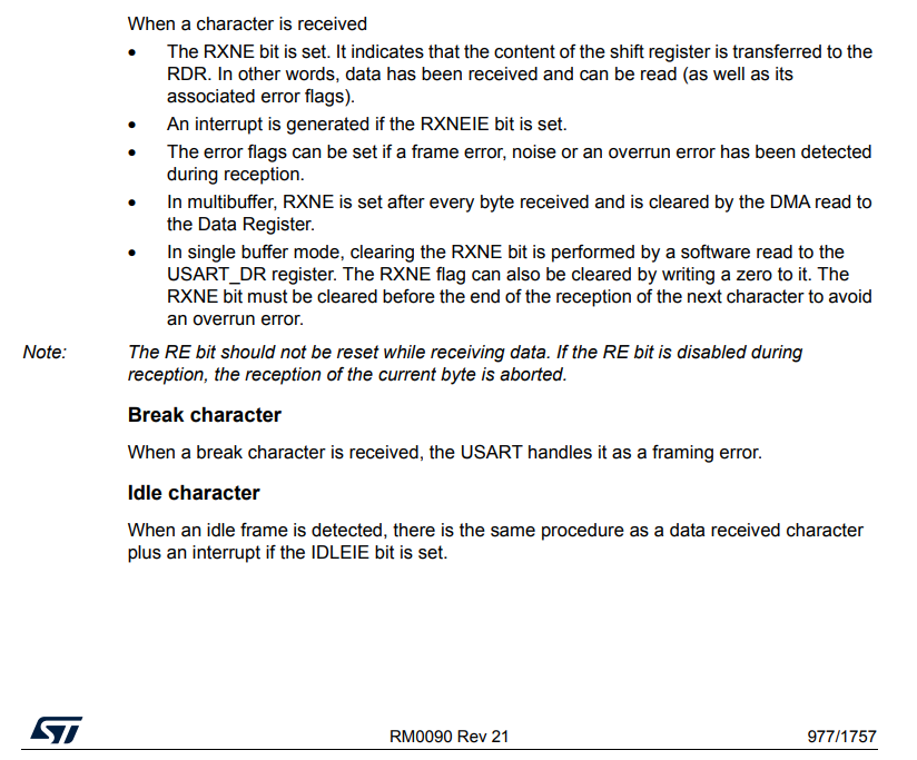

Tell me about multibuffer communication in the registers of the UART. We have a description of the RXNE flag. "The RXNE flag can also be cleared by writing a zero to it. This clearing sequence is recommended only for multibuffer communication". It turns out that when using DMA, you can reset RXNE this way. But why? After all, DMA does this automatically during operation.

this is from the reference manual:
Bit 5 RXNE: Read data register not empty
This bit is set by hardware when the content of the RDR shift register has been transferred
to the USART_DR register. An interrupt is generated if RXNEIE=1 in the USART_CR1
register. It is cleared by a read to the USART_DR register. The RXNE flag can also be
communication.
0: Data is not received
1: Received data is ready to be read.

I'm not talking about multi-processor. I speak for multibuffer communication.
as I understand it, in this mode in DMA two address spaces are used: DMA stream x memory 0 address register and DMA stream x memory 1 address register.
otherwise it is called Double buffer mode
2025-06-27 3:28 AM
So this?
2025-06-27 3:41 AM
yes, that's it. I just don't understand in what situation it might be necessary to do this: The RXNE flag can also be cleared by writing a zero to it.
2025-06-27 4:09 AM - edited 2025-06-27 4:15 AM
As it says,
"The RXNE bit must be cleared before the end of the reception of the next character to avoid an overrun error"
(my emphasis)
So it's just informing you that, in the multibuffer case, the DMA does take care of it - so you don't have to ?

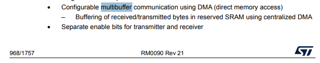

PS:
To the question in the title, "what do they mean by UART multibuffer communication?" I agree that the term "multibuffer" is never actually defined in the document!
Does it just mean, "any transfer using DMA"?
