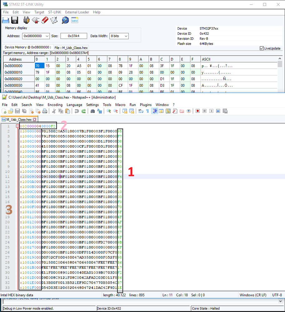

When I looked up the stlink utility , I couldnt see 1,2 and 3 shown in the figure?What are these can sb tell me about it?

2017-08-11 5:52 AM
The .HEX file is in an Intel format that defines record structure.
1) Checksum field for the record
2) is a segment address, other records use 16-bit address, so only describe 64KB regions.
3) Is the record size, address, and type

2017-08-11 7:57 AM
I also found this line at the first line => :020000040800F2
and this two at the last line => :040000050800018965
:00000001FFI didnt found these in intel hex

2017-08-11 10:54 AM
Did you read the Wiki? The .HEX is an ASCII encapsulation format, not all the record content gets into the memory of the device.
Record Type 04 at the front is describing what memory window the following record fall into, ie 0x08000000 being the base of FLASH memory
Record Type 01 at the end is a terminal record
Record Type 05 is the execution/entry address, nominal points at Reset_Handler
