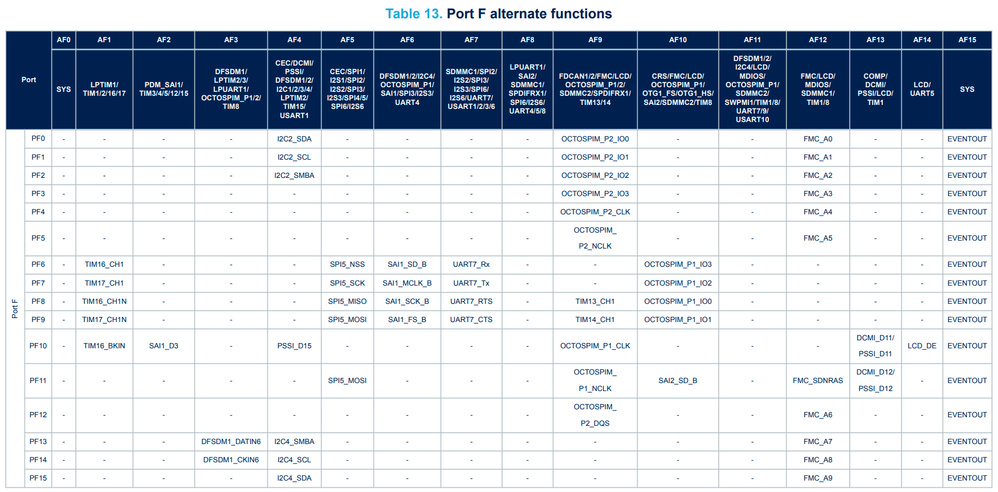

Those pins don't exists on the microcontroller chip itself. A package can only fit so many pins, and the ones that don't fit are left out. Since they're not on the chip, they wouldn't be on any of the connectors on the board either.
> what they are used for?
The datasheet lists all possible functions for all pins. Here they are for port F:
