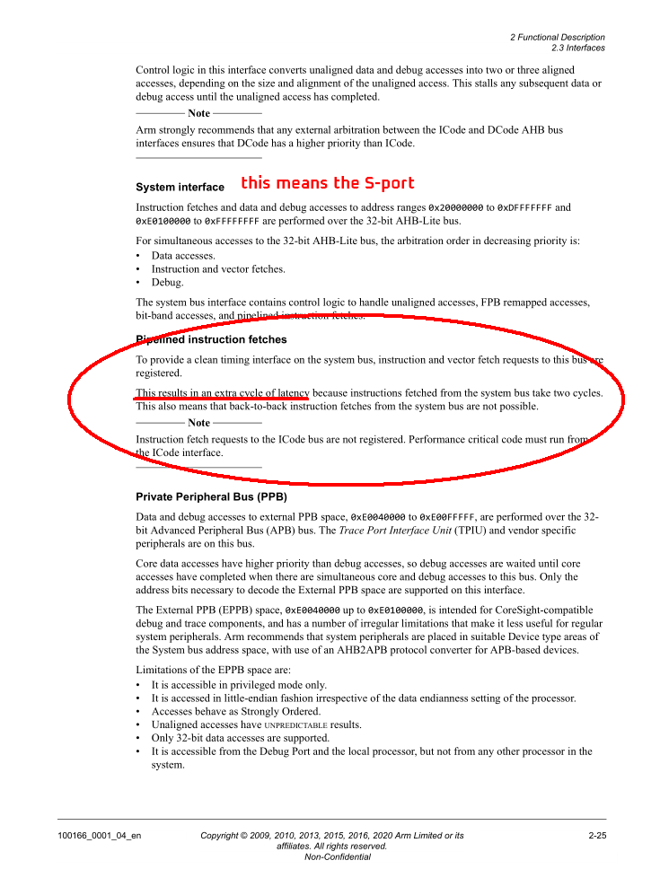

Hey @Community member,
thanks a lot for your quick response and for your answer! I thought the same thing about debugging. That's why I also executed binaries, that returned the cycle-count of the binary- sadly it didn't change anything about this cycle-behavior.
The reads through the S-Port might explain it. Is there anywhere I can read up on this penalization? This would at least explain 1 out of the 3 extra cycles. I also tested running the binaries exclusively on SRAM3, where only the S-Bus is available, which interestingly changed the behavior from 4 to 9 cycles per instruction.
I am not sure if your other 2 points apply, as I am consistently getting the same cycle count for various binaries of same length (I tested a couple of thousand binaries with this setup - fixed set of instructions btw.) as I need a fixed length of cycles. Stack is in a different SRAM.
Good to know that the RM isn't that precise!
(EDIT) your edit about the collisions on the S-port most likely explains it. I will check the technical update.
2022-09-08 4:51 AM
Your two points on the S-Port seems to explain my trouble @Community member. Thanks a lot! I guess there is not much I can do about this penalization. :) I suppose I could try to do the physical remap of SRAM1 as this seemed to increase performance quite a bit.
Yes, but note that the best solution meticulously splits instruction fetches to I port, program constants (literals) to D port (i.e. program runs from the 0-2000'0000 area) and data to S port (i.e. they are still mapped to above 2000'0000).

What RM says about SRAM2 and performance is misleading - they meant to say, that SRAM2 is permanently aliased at both the I/D bus and S bus, at two different address ranges. ST is not famous for meticulous wording in their manuals.
