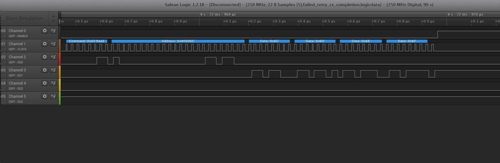

We found out that the old board had a bad rework. Fixing the rework seems correct the stuck at zero issue at DQ3 and jumps at the CS. However the QSPI test (write/ read back/ verify) still failing when ran in a loop. We have tried to reduce the clock frequency, but did not help. Noticed anything alarming on the capture I loaded last time?
2019-11-11 10:39 AM
It was unhelpfully annotated, and lacked signals on D2/D3. No real idea what the data patterns on the chip are (assume an incrementing pattern, prefer distributed LFSR noise), or the failure criterion. Normally one would use a GPIO trigger when the STM32 test fails, and then truncate the tail.
Only 20% contains data, end point doing a STATUS READ?
Not sure how I'm expected to debug this?
Here I tend to test single, dual and quad reads, proving I can CRC the entire array, and get consistent answers.
Then do the memory-mapping, and make sure that's coherent with the prior tests.
Got a usable UART-TX on this board? What are the QSPI pin assignments?
Show initialization. Show test loop/expectations.

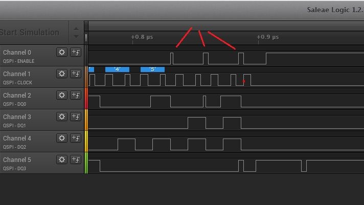

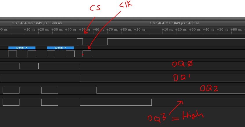

2019-11-11 2:57 PM
After fixing the rework issue, i notice these two issues.
1- DQ3 is running, however it is always high by default when not active.
2- we still see pulses on the CS. basically clock is running after CS is high.
Did anyone had experience with such issues?
2019-11-11 3:42 PM
You indicated earlier that you have a pull-up on DQ3, so I'd assume when CS is HIGH the thing goes Hi-Z from the memory side.
The lower set of traces seems to replicate the earlier issue where the signalling on D3 bleeds through or glitches CS. Check that the VCC domain that the pull-up goes to actual gets to the rest of the VCC net, and isn't a floating island.
Try Reading in DUAL or SINGLE modes, confirm they work.
Enumerate the STM32 pins used in your CUSTOM BOARD.
State a USART-TX pin that can be used for diagnostic output.

Based on Spec, I have pull up on both DQ2 and DQ3. why DQ2 is low when CS is high? Also I don't see why DQ3 has to be toggled when CS is high.
