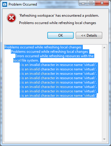

There is another issue as well. I created a project using links (root folder checkbox unchecked), and brought it up into TrueStudio. I was able to build the project fine. I then regenerated the code in Cube without making any changes, while the project was open in TrueStudio, and I get the following dialog box in TrueStudio after the files update due to the code regeneration. I can close the dialog box and build the project OK, but I'm not sure why the box pops up.
