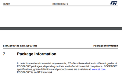

In the Datasheet:
Searching the ST site for, "ECOPACK" finds, among others, AN2639:
Soldering recommendations and package information for Lead-free ECOPACK MCUs and MPUs
The big thing is moisture absorption - see Chapter 6.
