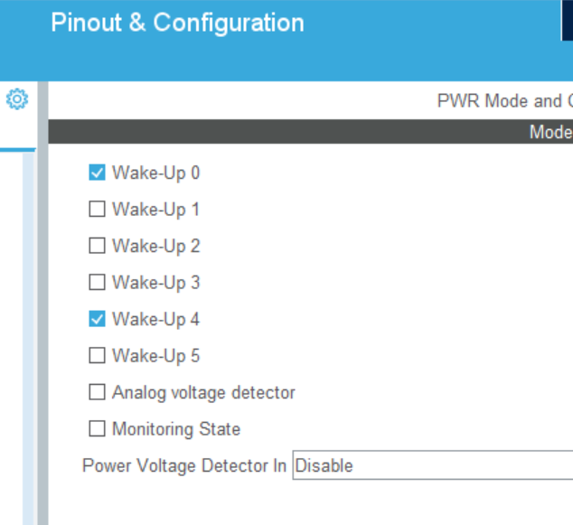

OMG! I found it. ST HAL Library engineers please take note. This is horrible. The wakeup pins in the datasheet and in the CubeMX configuration are 0 to 5.
However in the HAL PWR library.... surprise! they are 1 to 6.

#define PWR_WAKEUP_PIN1 PWR_WKUPEPR_WKUPEN1There is a mapping wakeup 0 is HAL wakeup 1 etc. Where is this mapping documented? Why even do this mapping? Who comes up with this stuff???? Thanks, You just cost me 1.5 days of wasted effort.
