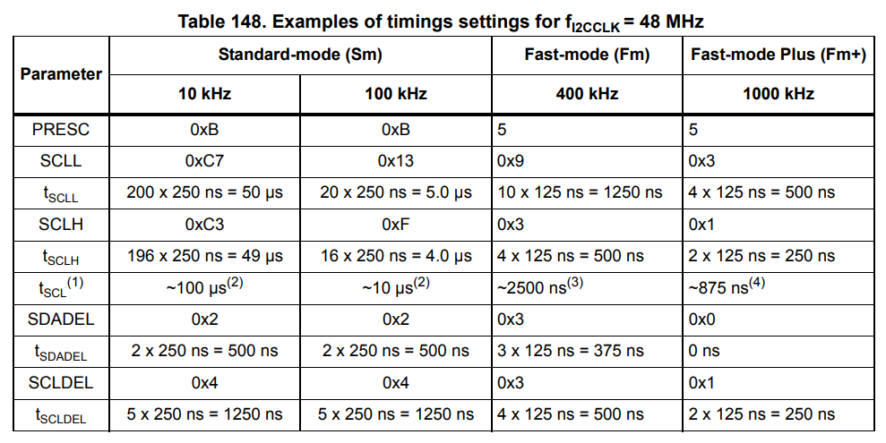

I2C timing is a bit opaque. I recommend extrapolating from the RM timing table examples. The RM goes into lots of details, and ultimately suggests using Cube. Of note, the example tables are for the same set of APB freqs, on a range of STM32 devices. So, having a 24Mhz etc clock makes sense for some variatns, but it uses the same table for H7, which may have a 200Mhz APB clock!

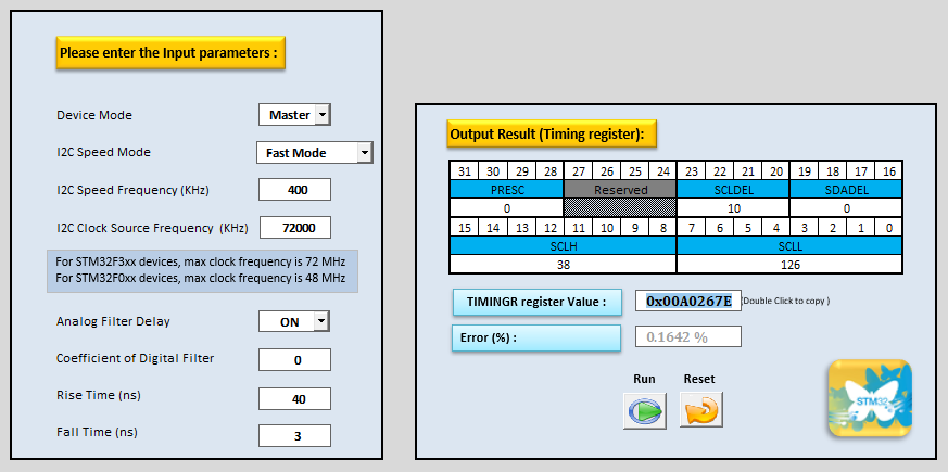

Thanks for all your reply. I am a beginner. Can you just kindly give me a number i can use for the i2c timing setting? or give me the best number of Rise time and Fall time?
BTW, the speed of usb-i2c i use is 400k and the evaluation board i2c clock frequency is 72M.
I also attach the " I2C_Timing_Configuration_V1.0.1.xls" here if you need.
Thanks a million!

I recommend to use STM32CubeIDE, it automatically creates timingR register value depending on clock configuration.
Then you can extract individual values and perform fine tuning based on reference manual. Let's say STM32CubeIDE gave timingR=0x40008EFF.

PRESC = 0x4Here is example of calculations for the table provided in reference manual:
' Calculation example 400khz i2c on 48mhz clk
i2cclk=48*10^6;
PRESC=5;
SCLL=0x9;
SCLH=0x3;
SDADEL=0x3;
SCLDEL=0x3;
i2c_t=1/i2cclk
i2c_t = 2.083333e-8
t_PRESC=(PRESC+1)*i2c_t*10^9 'ns
t_PRESC = 125.000000
t_SCLDEL=(SCLDEL+1)*t_PRESC 'ns
t_SCLDEL = 500.000000
t_SDADEL=SDADEL*t_PRESC 'ns
t_SDADEL = 375.000000
t_SCLH=(SCLH+1)*t_PRESC 'ns
t_SCLH = 500.000000
t_SCLL=(SCLL+1)*t_PRESC 'ns
t_SCLL = 1250.000000Actual I2C frequency will differ because of clock stretching, digital filter, etc.:
