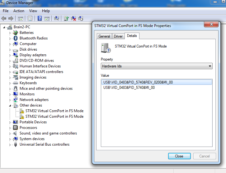

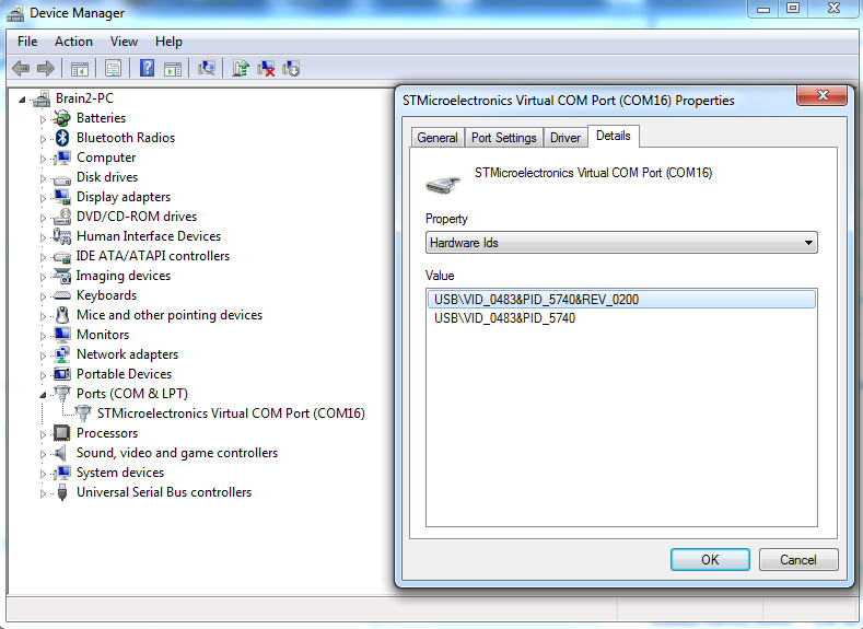

VID and PID are the same, but widows first found a composite device (two Virtual COM ports). Which is strange, because after installing 1.3.1. it become a single device. I'm compiling CDC example from
.2015-02-03 12:54 PM
I tried with another computer, the result is the same.
This is what I got, after discovery board was connected (Windows Update did not found a driver).2015-02-04 8:32 PM
Ah, I remember.
To get ST's CDC driver from Windows Update, The Device triad (class, subclass and protocol) of the CDC device should be (0x02, 0x00, 0x00). Windows treat a CDC device of Device triad (0, 0, 0) as you have seen. The VCP example in STM32_USB-FS-Device_Lib_V4.0.0 has correctly set it up, as follows. And then, this example finely works with Windows Update and VCP_v1.4.0\STM32_USB-FS-Device_Lib_V4.0.0\Projects\Virtual_COM_Port\src\usb_desc.c
/* USB Standard Device Descriptor */
const uint8_t Virtual_Com_Port_DeviceDescriptor[] =
0x12, /* bLength */
USB_DEVICE_DESCRIPTOR_TYPE, /* bDescriptorType */
0x00,
0x02, /* bcdUSB = 2.00 */
0x02, /* bDeviceClass: CDC */ <------ OK
0x00, /* bDeviceSubClass */
0x00, /* bDeviceProtocol */
But all of other examples of ST's libraries, including the latest Cube ones, don't work with Windows Update and VCP_v1.4.0, because these examples set the Device triad to (0, 0, 0).
The VCP example of STM32_USB-Host-Device_Lib_V2.1.0 should be revised, as follows,
\STM32_USB-Host-Device_Lib_V2.1.0\Project\USB_Device_Examples\VCP\src\usbd_desc.c
__ALIGN_BEGIN uint8_t USBD_DeviceDesc[USB_SIZ_DEVICE_DESC] __ALIGN_END =
0x12, /*bLength */
USB_DEVICE_DESCRIPTOR_TYPE, /*bDescriptorType*/
0x00, /*bcdUSB */
0x02,
0x00, /*bDeviceClass*/ <------ 0x02
0x00, /*bDeviceSubClass*/
0x00, /*bDeviceProtocol*/
Also, all of CDC_Standalone examples in STM32Cube should be revised.
\STM32Cube_FW_F0_V1.2.0\Projects\STM32072B_EVAL\Applications\USB_Device\CDC_Standalone\Src\usbd_desc.c
\STM32Cube_FW_F1_V1.0.0\Projects\STM3210E_EVAL\Applications\USB_Device\CDC_Standalone\Src\usbd_desc.c
\STM32Cube_FW_F1_V1.0.0\Projects\STM3210C_EVAL\Applications\USB_Device\CDC_Standalone\Src\usbd_desc.c
\STM32Cube_FW_F2_V1.1.0\Projects\STM322xG_EVAL\Applications\USB_Device\CDC_Standalone\Src\usbd_desc.c
\STM32Cube_FW_F3_V1.1.0\Projects\STM32373C_EVAL\Applications\USB_Device\CDC_Standalone\Src\usbd_desc.c
\STM32Cube_FW_F3_V1.1.0\Projects\STM32303C_EVAL\Applications\USB_Device\CDC_Standalone\Src\usbd_desc.c
\STM32Cube_FW_F4_V1.4.0\Projects\STM324xG_EVAL\Applications\USB_Device\CDC_Standalone\Src\usbd_desc.c
\STM32Cube_FW_F4_V1.4.0\Projects\STM324x9I_EVAL\Applications\USB_Device\CDC_Standalone\Src\usbd_desc.c
\STM32Cube_FW_L1_V1.0.0\Projects\STM32L152D_EVAL\Applications\USB_Device\CDC_Standalone\Src\usbd_desc.c
const uint8_t hUSBDDeviceDesc[USB_LEN_DEV_DESC]= {
0x12, /* bLength */
USB_DESC_TYPE_DEVICE, /* bDescriptorType */
0x00, /* bcdUSB */
0x02,
0x00, /* bDeviceClass */ <------ 0x02
Tsuneo

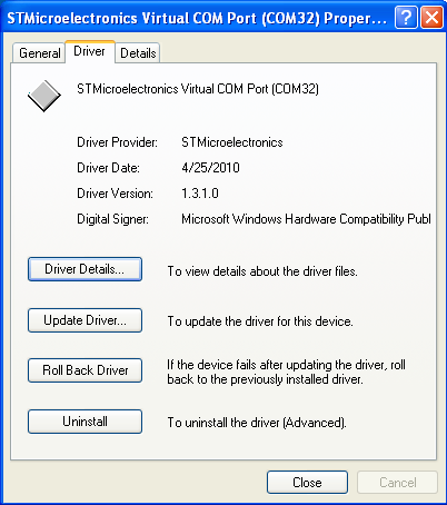

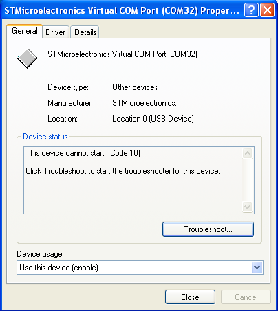

I did the change for device class in usbd_desc.c but in Windows (XP) I get this:

Clean up all of the VCP instances in trouble on your PC using USBDeview utility,
- Run this utility - Scroll the list to left, show up ''Vendor ID'' column - Click on ''Vendor ID'' label --> the list is sorted by VID/PID - Find VID/PID = 0483/5740 (in hexadecimal, 1155/22336 in decimal, shown on the source code) - (shift-)click on the all lines of this VID/PID to select them - right click on selected lines and choose ''Uninstall the selected devices'' On Device Manager, the VCP instances in trouble are scattered around under a couple of branches. It may be hard to find them all on Device Manager. If any one would be left, the trouble could stay in unfixed. Try USBDeview to clean them up. Tsuneo2016-10-10 4:46 AM
