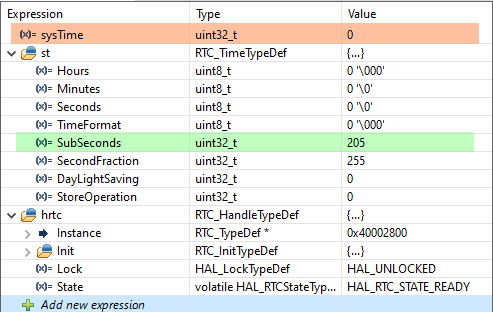

I have a very strange issue with an STM32F405RG/407VG regarding the RTC: it only works, when I am in debugging mode and add the “hrtc�? struct into live expression and the instance handle is open!

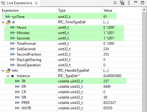

When I am in debugging mode, and have hrtc->Instance open in the “Live Expressions Window�? LED1 and LED2 toggle as intended.
hrtc->Instance closed => "sysTime" is not updated
hrtc->Instance open in Live Expressions => "sysTime" is updated
When I close the debugging mode LED1 keeps toggling, but LED2 stops toggling, which means that “sysTime�? is no longer updated.
Has anyone an idea, what’s going on here?

After reading time, you have to read date too.

@JW thank you very much! This did the trick!
My GetTime() function now looks like this:
void GetTime(void) {
RTC_TimeTypeDef st;
HAL_RTC_GetTime(&hrtc, &st, RTC_FORMAT_BIN);
#ifdef __STM32F4xx_HAL_H
RTC_DateTypeDef sd;
HAL_RTC_GetDate(&hrtc, &sd, RTC_FORMAT_BIN);
UNUSED(sd);
#endif
sysTime = (((((uint32_t)st.Hours) * 60) + ((uint32_t)st.Minutes)) * 60) + (uint32_t)st.Seconds;
}@PHolt: luckily i don't need fractional seconds ATM, my "complication bucket" is full for today ;) - but thanks for the warning!
