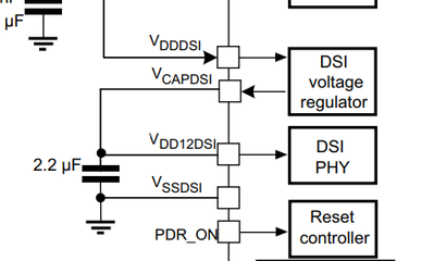

I am working on a system based on the STM32H747BIT6 MCU and do not plan to use the DSI interface. I have searched through various forums but still have some doubts about the proper power pin configuration when DSI is not in use. Here is what I have so far:
Does anyone have experience with this setup or any recommendations on the best approach for VDD12DSI?

The same configuration as for STM32F777:
No need for external regulator. You need just to connect VDD12DSI to VCAPDSI.
Hope that answers your question.

2025-03-24 5:54 AM
Please see answers in this thread:
Solved: Can DSI pins on STM32H747 be left unconnected if n... - STMicroelectronics Community

I'm still confused about the details. The reference manual says to connect VDDDSI to the global VDD. Then after connecting VDD12DSI and VCAPDSI, should I connect those to VDD global? That sounds little weird to connect the (1.2V?) to my global 3.3V VDD.
2025-05-18 7:31 AM
No, you should not connect VDD12DSI and VDD. Why would you? They are clearly disconnected in the figure and there is no text instructing you to connect them.
