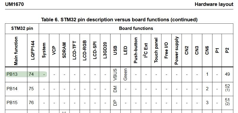

actually I use CAN2 at STM32F429ZI. but, ı can not connect PB13 because of VBUS. I need to disable VBUS. but, I dont know how ı can

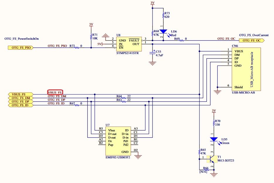

The use of PB13 VBUS is specific to the STM32F429I-DISCO board design.
Review the schematic, follow the traces, and try to determine if those can be cut or modified to meet your requirements.

The question is poorly framed. The OP is using the STM32F429I-DISCO where PB13 is wired as VBUS and connects to an LED, etc

Thank you for answered. When I look datasheet, it says you can use PB13 pin as CAN2_Tx

That is as far as the chip itself is concerned.
On the Discovery board, as
Turvey.Clive.002
has explained, the pin is used to detect the presence of VBUS.We’re moving the ST Community to a new platform to give you a better and more reliable community experience.
