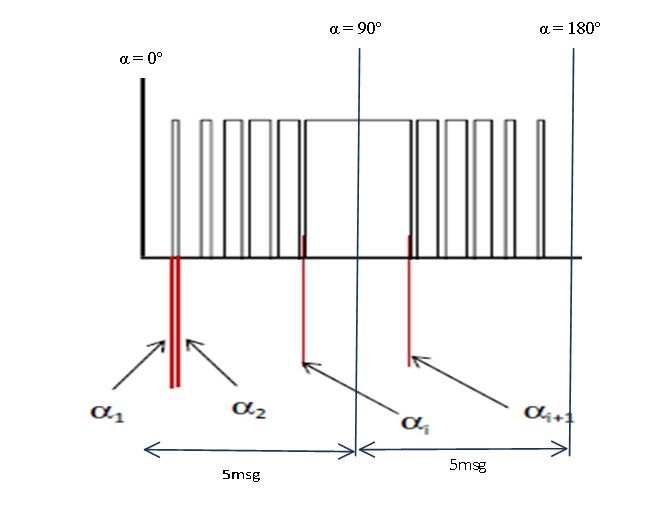

I need to load the table with alpha values from 0 degrees to 90 degrees. Before the end you should be loading from 90 to 180. You can not split the tablets because the values are odd and I need that high or low levels remain inthe table changes. These levels SRC_Buffer maintains only [0].
notice that the values in Table 90 to 180 are a mirror table 90. TIM1- 0> CCR1 = SRC_Buffer [0] = (5000 - Tabla_Buffer [Table] [18]);2015-03-22 2:02 AM

The regulation requires the refreshment table at 90 degrees or what is the same five msg2015-03-22 8:46 AM
So, I'm assuming 5ms (200Hz). I'm not convinced you need to build the entire table, you could build 20 entries initially (0..19), at HT (10 entries) you could rebuild/replace the first 10 (20..29), at TC the next 10 (30..39), etc.
Or you could do 5 at a time, and not stuff the CCR1 value, or CNT2015-03-22 8:53 AM
I'm missing the frequency/period details, the relationship of the 5 milliseconds, 5 messages, 19/38 samples, why the entire sequence can't be in a single table, or built on the fly.
2015-03-22 2:20 PM
The frequency is 100Hz. The table has 19 values, ranging from 0 degrees to 90 degrees. The values from 90-100 degrees to complete the cycle are constructed by the mirror table from 0 degrees to 90 degrees.
