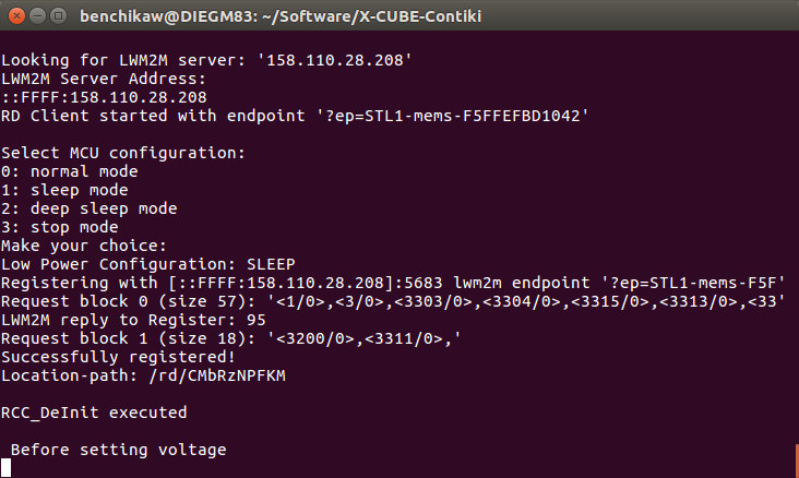

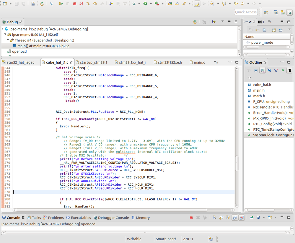

As shown in the following print screen, I added other printf after the next instructions. But, the message before
__HAL_PWR_VOLTAGESCALING_CONFIG function appears, while other messages does not appear. It means that all instructions before this function are executed, while this function stops the execution of the next instructions.

What is the system frequency at the moment of attempted switch?
2017-10-13 9:11 AM
For low frequenc
y (lower than 4MHz: 1, 2 or 4MHz).
BR
WBC
2017-10-13 9:33 AM
Are you sure this is the frequency *before* you try to switch?
Why are then RCC_ClkInitStruct items filled *after* the switch?
2017-10-13 9:36 AM
I switch from 32 MHz to
low frequenc
WBC
