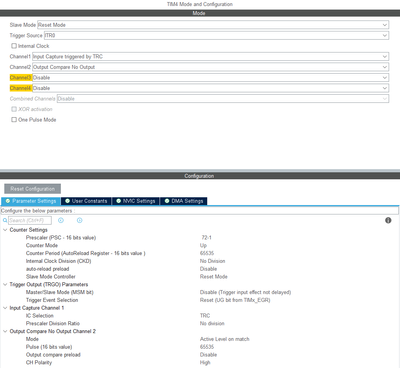

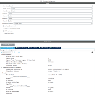

I know that this post is very old, so I assume you fixed it :grinning_face_with_sweat:, but this might be helpful to someone else.
On the STM32F105, I used TIM1 and TIM4 in the very same configuration of you to read 2 hall sensors (that produce the very same signals of a quadrature encoder):
TIM1 in encoder mode, and trigger output on Compare Pulse (OC1).
TIM4 as slave in reset mode with channel 1 as Input Capture triggered by TRC.
Here my timers config (extracted from the STM32CUBEMX):
TIM1.AutoReloadPreload=TIM_AUTORELOAD_PRELOAD_DISABLE
TIM1.EncoderMode=TIM_ENCODERMODE_TI12
TIM1.IC1Filter=1
TIM1.IC1Polarity=TIM_ICPOLARITY_RISING
TIM1.IC2Filter=1
TIM1.IC2Polarity=TIM_ICPOLARITY_RISING
TIM1.IPParameters=EncoderMode,AutoReloadPreload,Period,IC1Polarity,IC2Polarity,IC2Filter,TIM_MasterOutputTrigger,TIM_MasterSlaveMode,IC1Filter
TIM1.Period=65535
TIM1.TIM_MasterOutputTrigger=TIM_TRGO_OC1
TIM1.TIM_MasterSlaveMode=TIM_MASTERSLAVEMODE_DISABLE
TIM4.Channel-Input_Capture1_from_TRC=TIM_CHANNEL_1
TIM4.Channel-Output\ Compare2\ No\ Output=TIM_CHANNEL_2
TIM4.IPParameters=Channel-Input_Capture1_from_TRC,Prescaler,Channel-Output Compare2 No Output,Pulse-Output Compare2 No Output,OCMode_2
TIM4.OCMode_2=TIM_OCMODE_ACTIVE
TIM4.Prescaler=\ 72-1
TIM4.Pulse-Output\ Compare2\ No\ Output=65535Here the screenshots:
