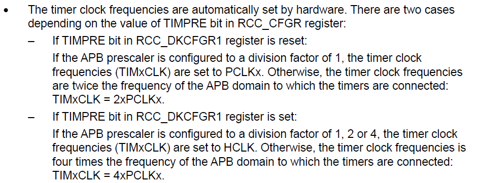

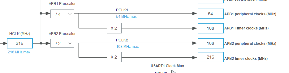

2021-02-24 8:50 PM
I have to update this thread.
The above code MIGHT work for other STM32 MCUs but it does NOT work for the STM32F7 in all cases:
In my case:
Since the APB1 Prescaler is not "/1" then the timers are actually running at 2x the PCKL1 frequency returned by the HAL_RCC_GetPCLK1Freq() function.
2021-02-25 12:01 AM
There's probably a dedicated incantation in Cube/HAL to determine the timers' clock. I don't Cube.
