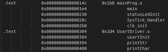

Here is what's inside systick handler:
void SysTick_Handler()
counterVal += 1;
GPIOA->ODR ^= GPIO_ODR_ODR_5;
}If I set a break point on it, it does not reach it.
The stack pointer is at the top of my stack on the reset.
Here is the map file, and it appears the handler is at 0x0800028c:
Could this be the issue?
2020-04-13 10:37 PM
What's its value?
Okay, and how does the vector table (starting at 0x0800'0000) look like in disasm?

Actually I must've misread the stack pointer, it is nowhere near the top of the stack. It's at 0x20000f38, and the top of stack is 0x20004ffc. Which is odd considering all I'm doing before the systick exception is called is incrementing a value and printing text. I also noticed the LR is all F's, which is odd. I'm not sure of a circumstance that would happen. Here's a screenshot:
The vector table looks like this (note the address of SysTick_Handler is different because I changed some other code a bit:
The vector table has 0x0800028d, and the address of SysTick is 0x0800028c. 0x28d seems reasonable considering I'm compiling with thumb, which does 16-bit instructions if I remember correctly.
