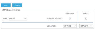

The DMA is configures this way:
I tried every configuration possible but nothing works. My question is why the DMA only graps the first byte of a color and what I have to change in order to send the real color.

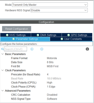

2023-07-02 6:02 AM
2023-07-02 6:10 AM
As i can see the spi is configured as 8 bit data size and your dma is 16bits.
Make spi 16 bits and see if it works.

2023-07-02 7:01 AM
you didnt set memory increment - so dma just doing 1 transfer . not very useful...
check "memory" !
2023-07-02 10:23 AM
Initially I had it marked. I have been doing tests and it stayed unchecked. But the same thing happens.

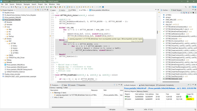

2023-07-02 10:26 AM
Initially the DMA was configured at 8 bit but doing tests I changed It. The st7769_witedata():
2023-07-02 11:01 AM
How is "disp_buf" declared? You may need to use "&" when calling ST7789_Write_Date ... like :
ST7789_Write_Date(&disp_buf,...
