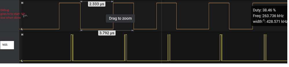

I have all the SPI wires on a scope and only the SPI5_NSS / USART7_CTS (PF6/PF9) shows a signal.

2022-11-30 8:04 AM
oh boy, starting to maybe get this...
So the line I see working is my out data, I know this because changing my data out matches (hard to read without a clock). and my MOSI is configure as PF9 and that happens to be the Pmod 1 (1 SPI5_NSS / USART7_CTS (PF6/PF9) ) Where I see data on the wires
The IOC says SPI5 clock is on PH6 but the board says it can ( or should be ) on PF7/8
So there must be a way to set SCK and MISO to PF pins, but how?
I also see uart7 is in use in my project, maybe this is a conflict?
