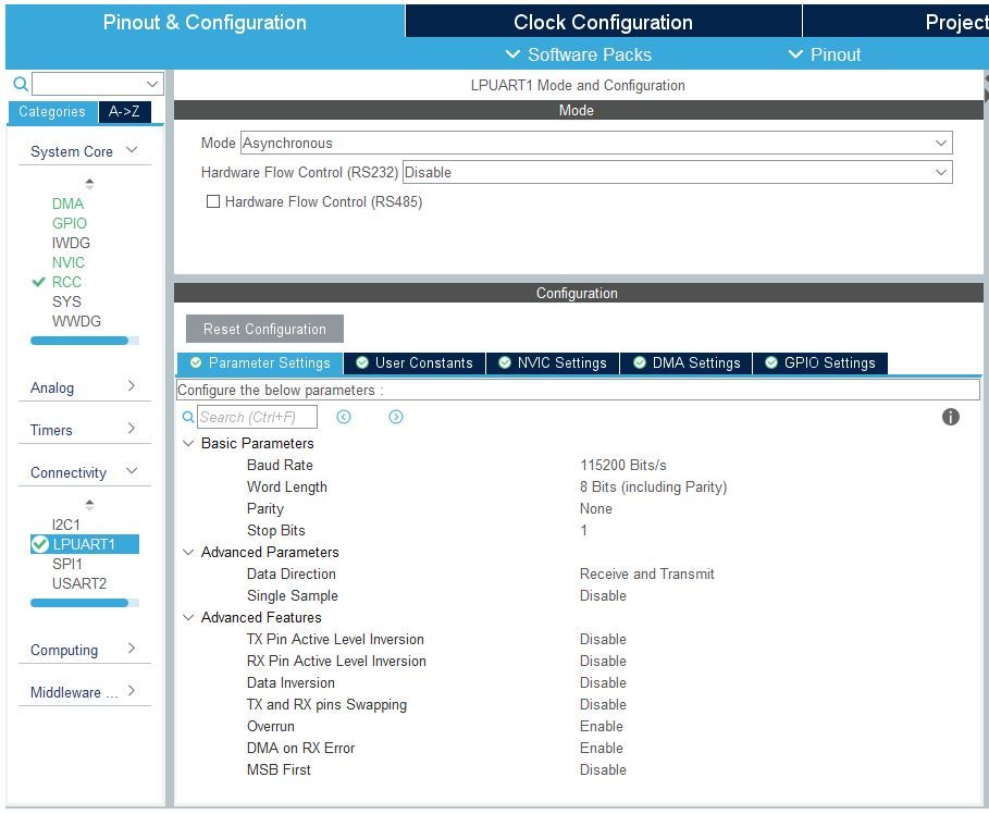

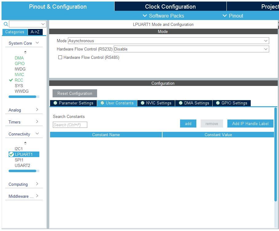

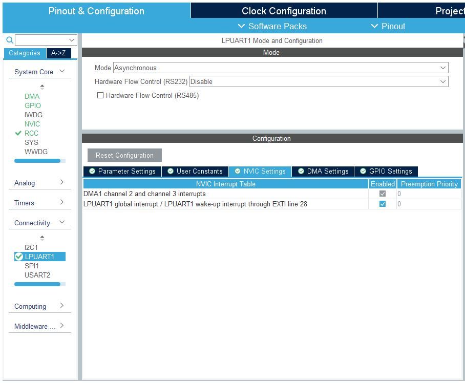

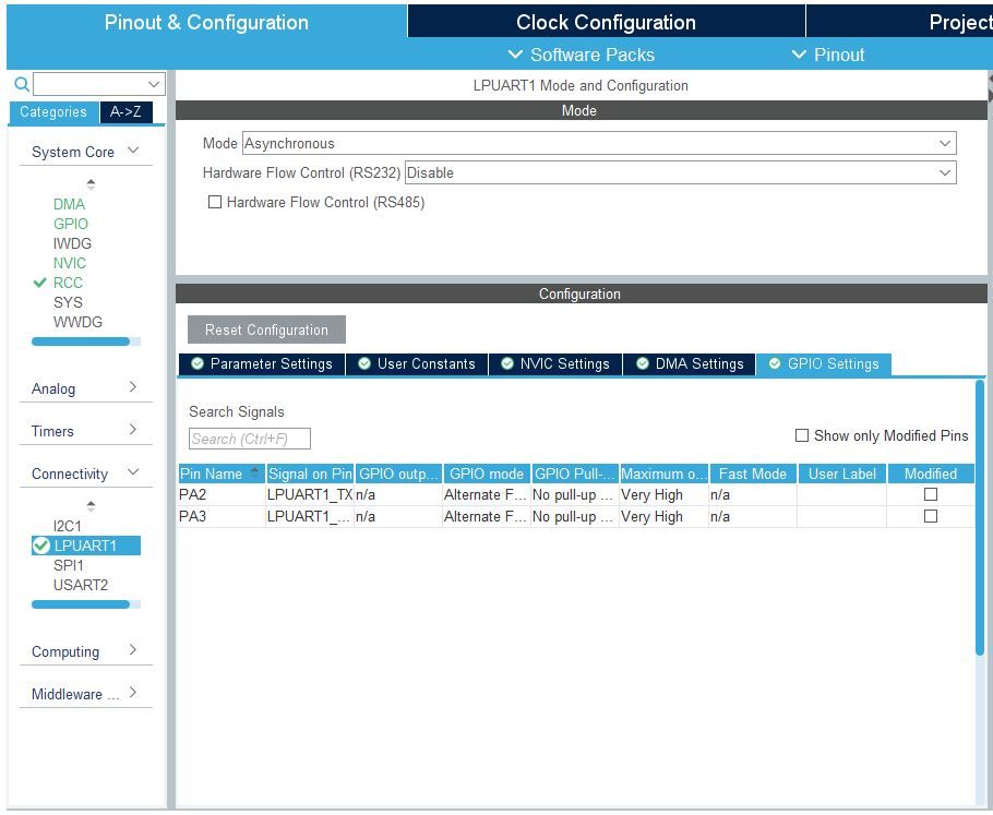

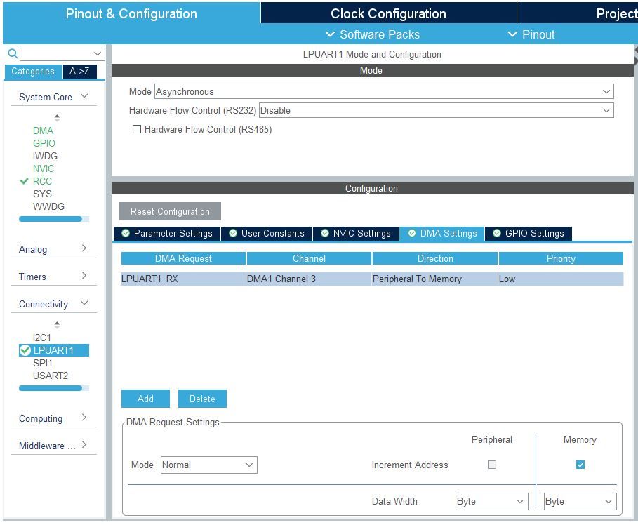

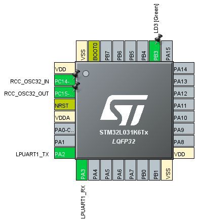

Please take a look at the following screenshots:
I just added the following lines of code:
/* USER CODE BEGIN PV */
uint8_t rx_data[4] = {0};
/* USER CODE END PV */
/* USER CODE BEGIN 0 */
void HAL_UART_RxCpltCallback(UART_HandleTypeDef *huart)
HAL_GPIO_TogglePin(LD3_GPIO_Port, LD3_Pin);
HAL_UART_Receive_DMA(&hlpuart1, rx_data, 4);
/* USER CODE END 0 */
/* USER CODE BEGIN 2 */
/* USER CODE END 2 */
I just wanted to see the reaction of the LED on the reception of 4 bytes. But no activitiy yet.
> Are there any restrictions in using the RX line on PA3 or in using the LPUART1 in receiving data?
> Check the relevant solder bridges/jumpers on Nucleo. Aren't these pins connected to the on-board ST-Link by default?
Yes, they are connected by default via SB2 and SB3 and I haven't changed that.
