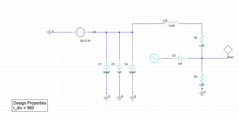

10dbm is 2 V pp, not 4 Vpp. Add a capatictor between OXCO out and STM32 Osc_In and 100 Ohm each from OSC_IN to GND and VCC and that should be do the job.

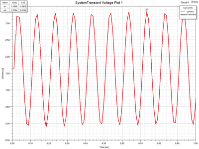

In my simulation setup, I have set the OSC IN resistance at 200 kΩ due to the R_feedback value being 200 kΩ. For the voltage divider resistor, I initially used 100 Ω but found it did not achieve a 3.3 Vpp ; hence, I adjusted it to 560 Ω. Regarding the capacitor for DC blocking, setting it to 1 nF seems appropriate to achieve a 3.3 Vpp signal level.

Your OCXO is power by 5 Volt. So absolute highest possible swing is 5 VPP. They guarantee 10 dBm at 50 Ohm, that is 2 VPP. The OXCO output seems to have a capacitor at the output, so you see +/- signal. RM0481 in 11.4.1External clock source (HSE bypass) talks about what to set for "low swing (analog) " signals. The needed HSEON bit needed to be set for analog input probably biases OSC32_IN in the right way for AC coupled inputs.
With your 5 Volt OXCO directly connecting the OXCO output without 50 Ohm termination may cause voltages to high at the input. I assume there is also another consumer for the OXCO, that probably terminates the line. So AC coupled input should be fine. If not, perhaps consider a 3.3V OXCO or terminate OXCO with 50 Ohm and AC couple to OSC_In.
