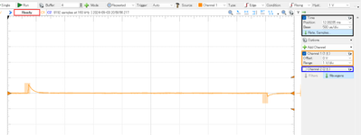

2024-09-03 3:51 AM
Orange is CS and blue is SCLK.

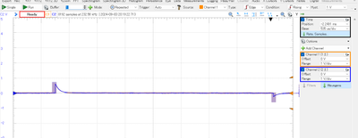

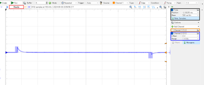

2024-09-03 4:29 AM
Orange is MOSI and blue is MISO.

2024-09-03 4:41 AM
The blue and orange colors are overlapped so that only blue is visible.
Sorry, but I can only do 2 channels.
Best regards.

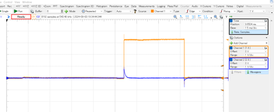

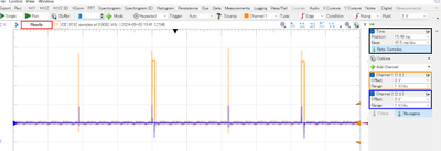

2024-09-03 4:48 AM
So shift the traces to not overlap!
2024-09-03 4:54 AM - edited 2024-09-03 5:01 AM
How about this?

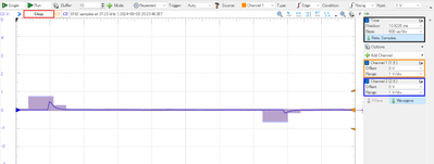

2024-09-03 5:01 AM
Sorry, I made a mistake.
This is the original one.
