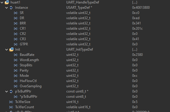

And the contents of huart1 at the time of the call?

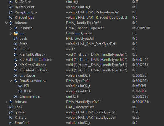

2023-09-13 6:11 AM
Hi TDK, after I tried everything and found out that if I turn 'Optimization Option' from 0 to 1 then it worked. But btw, may you give me a clue which one I should look in 'huart1' ? I would like to know what is really a root cause of this.
2023-09-13 6:29 AM
You're looking to see that the contents are properly initialized and valid at the time of the call.

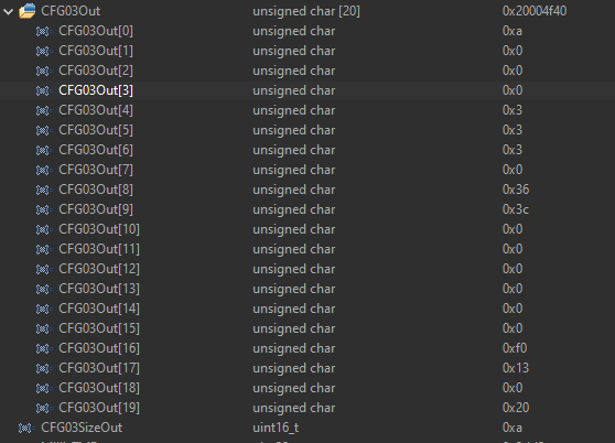

Here is unsigned array to print out thought UART and size to print.
And here is huart1 data
