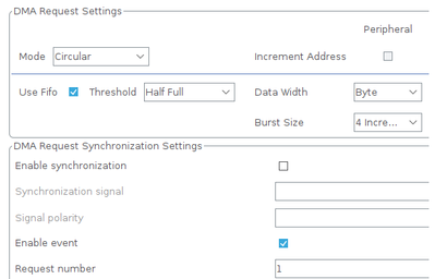

2024-01-04 9:15 AM - edited 2024-01-04 10:17 AM
> It'd be really nice if the HAL had a HAL_ADC_DMA_MultiBufferStart() or something like that.
For "double buffer" - it has. Is called : circular buffer, because you want "endless" continuous stream - right?
Using it , is very easy : just in Cube set circular buffer, inc. memory, source&destination size (byte, word..), and enable callbacks in "Advanced settings" .
And in main : on half- and full buffer callbacks move data , wherever, to use it.

2024-01-04 4:28 PM
Code I posted is out of CubeMX examples for stm32H743zi2 , all comments as it is. You can download it here:
https://www.st.com/en/development-tools/stm32cubemx.html
Regarding DMA1_Stream1 depends on the uCPU, some have dma channels "hard-wired" to peripheral (F4 and older) , but using modern product like H7 series is allow to link any dma to any peripheral - there is a MUX, so software defined map.
A few years ago I developed multy-buffer dma-spi driver. My line of work was to take "properly written by ST experts" HAL_SPI_TransmitReceive_DMA than replace if (HAL_OK != HAL_DMA_Start_IT(hspi->hdmarx, (uint32_t)&hspi->Instance->RXDR, (uint32_t)hspi->pRxBuffPtr,
for
if (HAL_OK != HAL_DMAEx_MultiBufferStart_IT(hspi->hdmarx, (uint32_t)&hspi->Instance->RXDR, (uint32_t)pData, (uint32_t)pData2, Size))
You can do same thing with adc.
