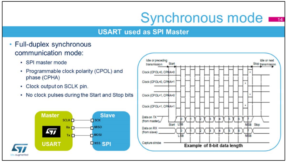

When using an STM32L0 USART in SPI master mode, if the Slave needs a low level at the beginning of the frame and a high after the data byte, can I use any GPIO as NSS master to output this levels?
2020-04-15 3:41 AM
Yes.

2020-04-15 5:49 AM
I took this terminology from this ST presentation <USART used as SPI Master (page 14)>. But they don't specify anything about which pin should apply the NSS signs for the slave.
Thanks for your clarifying answer!
