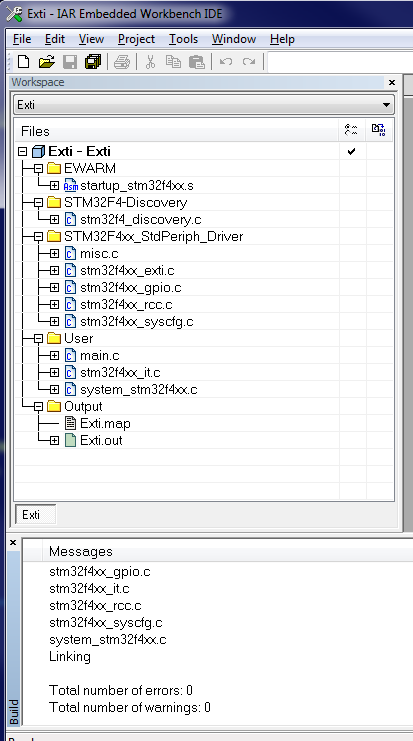

From the error I'm going to guess you have IAR of some version, again which you fail to mention.
Why don't you just load the EXTI example workspace and make the thing? It build fine in an IAR EWARM 6.40 evaluation/demo edition.2013-04-25 2:13 PM
it's ok i solved the problem by adding the file ''stm32f4xx_syscfg.c''.
thanks againWe’re moving the ST Community to a new platform to give you a better and more reliable community experience.
