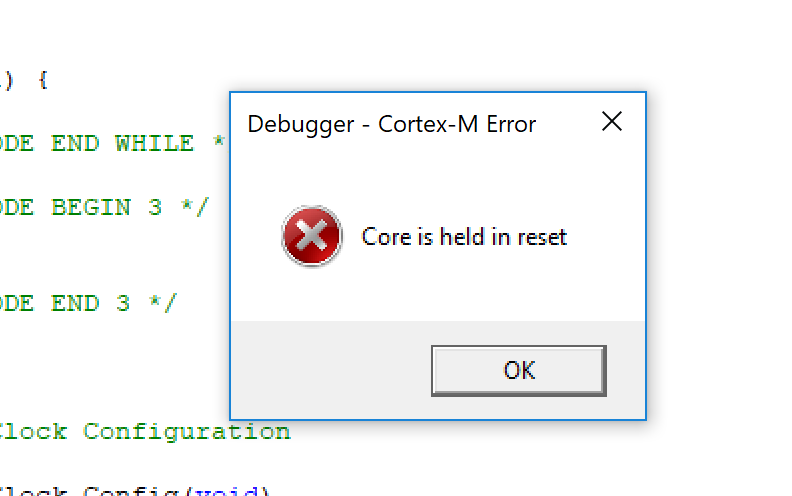

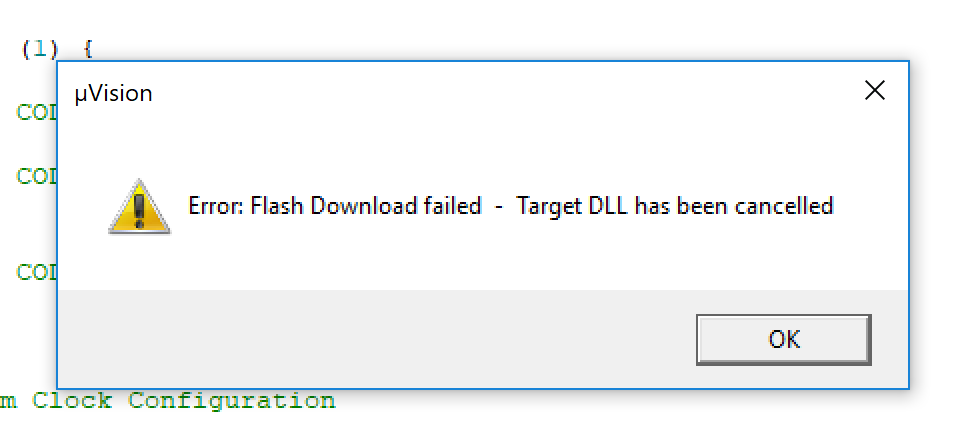

Hi Clive One, I have tried what you said today, by adding power to VDDA/VERF+, The FAIL.TXT has gone, however, when I upload code from Keil (I am using STM32Cube MX combined with Keil to program the MCU), it returned with Core is held in reset. And I am not able to upload any code.
And then I tried to add a 4.7uF capacitor between VCAP (Pin 30) and GND, as soon as added it, the FAIL.TXT Jumps out again, original problem has come up again.
Is there anything else I've missed? I will read through the document that you recommended, but if you have any suggestions, that would be great.

2017-07-14 10:56 AM
VSSA should connect to GROUND
Check voltage levels on VCAP pin and NRST pin.

VSSA should not 'go through' the capacitor to ground, it should be at ground potential.
NRST should not be connected to ground permanently.
If you hold NRST low the device is not going to function, because you're 'Holding the Core in Reset'
Perhaps you have someone with some electronics experience/qualifications who can help you
