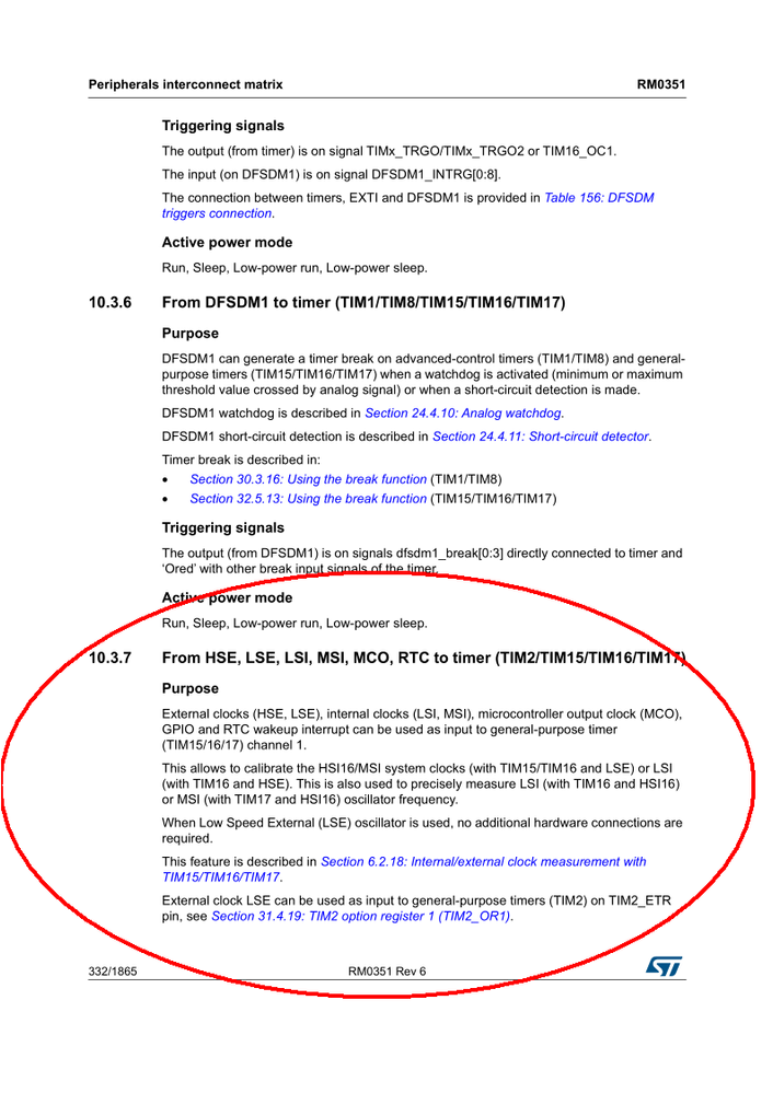

Is it possible to use the LSE clock 32.768 KHz as external clock source for TIMxx on the STM32L4 series ?
I have an application running on STM32L1 and using external ****-source mode 2 for TIM10 as described in Figure 131 of the Reference Manual RM0038. I would like to port this application to the STM32L4 but I'm not sure it's possible, I can't find the equivalent diagram in the reference manual RM0351.

Read then TIM2_OR1/TIM15_OR1/TIM16_OR1 registers description.

LSE can be used as clock source:
TIM15->OR1 |= TIM15_OR1_TI1_RMP;
