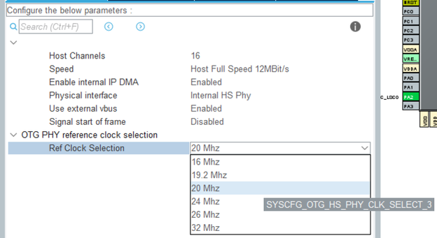

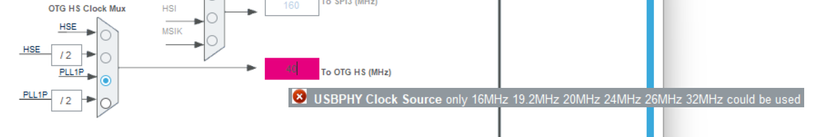

I try to configure STM32U5A9 MCU with CubeMX, but I find no option to configure USB 60MHz clock.
The only available clock setting called "OTG HS Clock" cannot be set to a value larger 32HMz and probably needs to match setting under "Pinout & Configuration" where this time it is called "Ref Clock selection" - see screenshots below.
Where do I set 60MHz clock as described in RM0456? Instead, CubeMX offers 16/19.2/20/24/26/32MHz clock selection. In RM0456 I found no 16/19.2/20/24/26/32MHz clock values mentioned.
