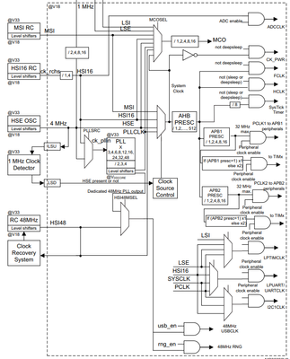

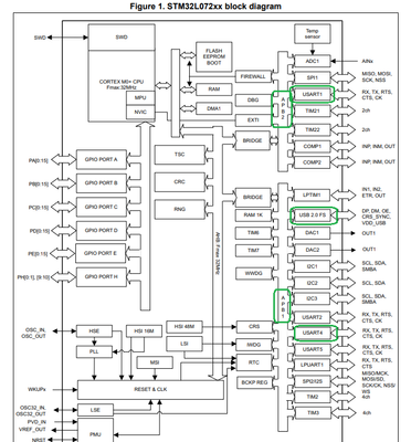

I suspect there is some difference in clock source / implementation between USART1 and USART4 based on the fact that CubeMX only shows USART1 with a configurable clock source / source mux. Is that the case?

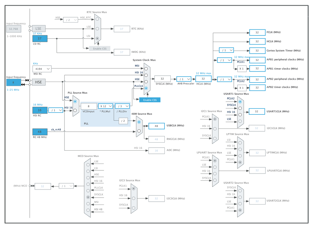

Thank you for sharing ! Indeed your hypothesis seems interesting on right clocks between different blocks - USB, System , APB1 and APB2 :
If possible to let us know your Clocks settings ?
Thanks again.

Thank you for the reply.
Here are my clock settings:
void SystemClock_Config(void)
RCC_PeriphCLKInitTypeDef PeriphClkInit = {0};
__HAL_PWR_VOLTAGESCALING_CONFIG(PWR_REGULATOR_VOLTAGE_SCALE1);
RCC_OscInitStruct.PLL.PLLMUL = RCC_PLLMUL_12;
RCC_OscInitStruct.PLL.PLLDIV = RCC_PLLDIV_3;
Error_Handler();
RCC_ClkInitStruct.APB2CLKDivider = RCC_HCLK_DIV1;
if (HAL_RCC_ClockConfig(&RCC_ClkInitStruct, FLASH_LATENCY_1) != HAL_OK)
Error_Handler();
PeriphClkInit.PeriphClockSelection = RCC_PERIPHCLK_USART1|RCC_PERIPHCLK_USB;
PeriphClkInit.Usart1ClockSelection = RCC_USART1CLKSOURCE_PCLK2;
PeriphClkInit.UsbClockSelection = RCC_USBCLKSOURCE_PLL;
Error_Handler();

Is this a custom board? Is USART4 routed close to USB lines? Perhaps show a picture of the routing of these two signals?
Would suspect a noise issue rather than something inside the chip preventing it from working. Surely the peripherals are independent at the internal level.
