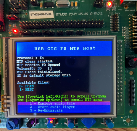

2024-03-06 1:05 AM - edited 2024-03-06 2:12 AM
If I change the "object format code" by PTP_OFC_Association I can get the directories list on the SD card.
At least the Canon answers/understands some requests...
I tried with Object format code between 0x3000 and 0x3810 without success.
May be the Canon restricts the access on root and allows on DCIM directory.
Is it possible in USB-PTP to navigate in subdirectories?
